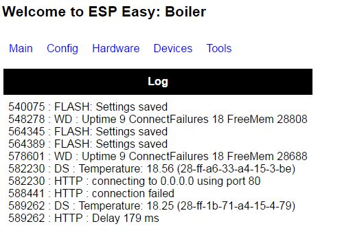

I had an older, modified version running logging to a public server
I waned to try now the newer releases . no modifications made
When using generic HTTP Protocol - then "Use Hostname" - the log always says connecting to 0.0.0.0
I even tried to declare my router as DNS in the optional settings
Any ideas what i´m doing wrong ?

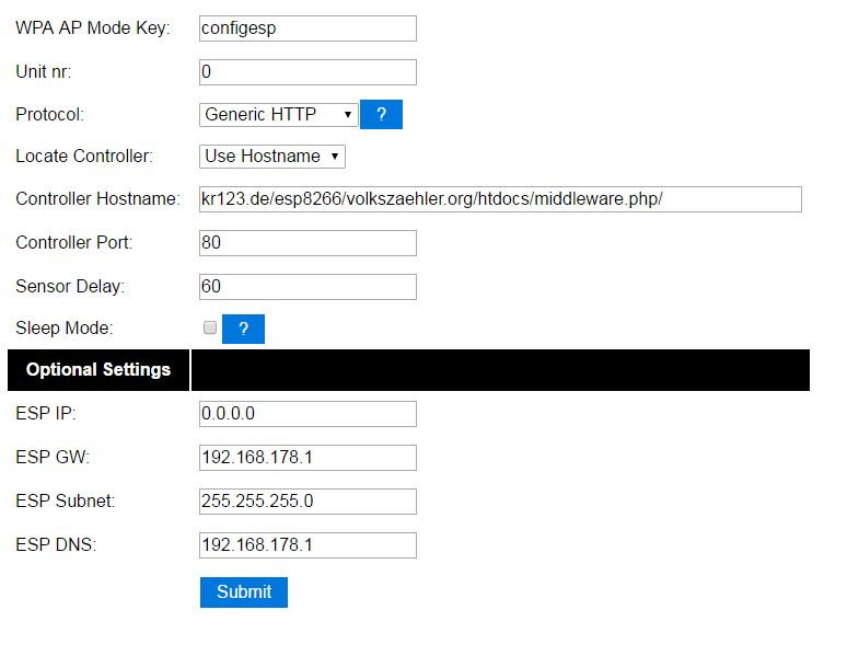

In the field Controller Hostname should appear only the host-part of the URL. kr123.de
This part is then resolvable by DNS
The rest of the URL has to be in Mqtt advanced settings.
The optional settings in the screenshot are for fixed IP instead of dhcp client

I ran into a similar problem because I had included https:// in the hostname. When I removed that everything worked.
