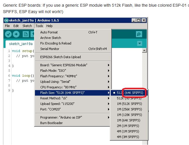

When I started with the ESP-01 I followed the Arduino IDE Tutorial step by step, and here I made a big mistake. Give it a reason, age, reading with closed eyes or something like that :D
512K (64K Spiffs).JPG (62.53 KiB) Viewed 7328 times
I filled all my ESP's with 512K (64K Spiffs) and then with OTA I selected the 1024.bin file.
On this moment i can't try the solution of Martinus, I don't have new ESP's available.
