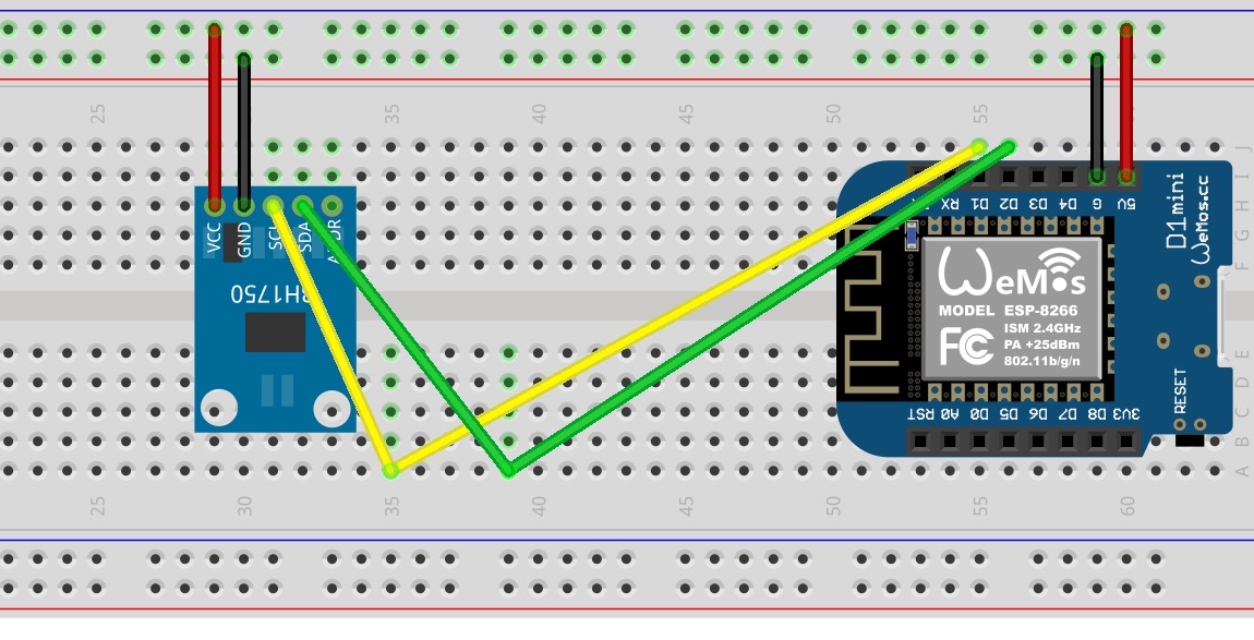

I connected my first sensor a Lux meter, BH1750 to D1/D2 pins:
Nice, it's working.

Re: My first Wemos D1 + Easy ESP: need help in wiring
It is very simple.
If all sensors are I2C then connect all SDA together and all SCL together.
Also there must be a a pullup resistor on SDA and one on SCL but probably one or more of your sensor boards do already have a pullup resistor. In that case the external pullups are not needed anymore.

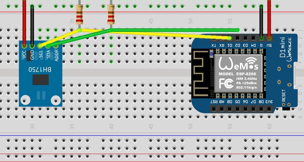

Hi Costo, thank you for the fast response.
Is this wiring with pull up resistors correct (4K7 resistor is between SDA/VCC and SCL/VCC)?
The BH1750 boards that are common , like GY-302, do already have their own pullup resistors, so first try without extra resistors.
If your sensor boards work on 3.3V you never need a level converter. If your sensor boards work at 5V you can most of the time do without levelconverters but you must check that your 5V sensor boards do not have pullup resistors on the board that are connected to 5V. In that case you better use a level converter.
BMP280 works perfectly at 3.3V
edit:
By the way, I see a dangerous connection in your fritzl schematic. You have connected the 5V to the power rails, you should not use that voltage for 3.3V sensors, only for sensors that do not work with 3.3V

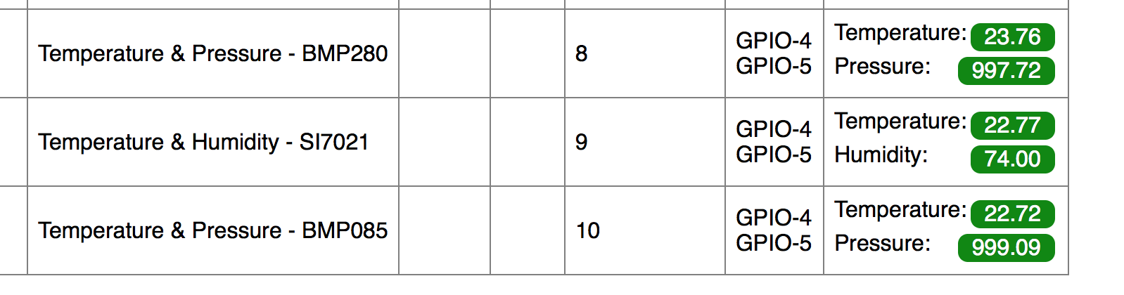

...so it's running from last night:
What is the big difference in the temperature reading?
There is also a difference in the pressure reading. As I checked on the local meteorology site the BMP280's reading is closer to the reality.
Is there any formula to convert pressure reading to the more used sea level value? Like here: sea level pressure converter.
- BMP280: seem to be totally inaccurate, the temperature is 1C above of the actual temperature.
- SI7021: OK / it's showing similar values as my weather station
- BMP085: OK / it's showing similar values as my weather station
Assuming your BMP280 is not next to something a little warmer and nothing on the module itself is generating heat (for example 5V feeding a 3.3v module) they are not completely accurate. Check the data sheets,absolute accuracy for temp can be off by as much as +-.5 at 25C and pressure as much as 1.7 hPa. Relative accuracy is +-0.12 hPa or 1m.
Absolute Accuracy of the BMP085 is +-2.5 hPa and +- 1.5C at 25C.
The SI7021 is +-0.4C
If you have access to Lab quality instruments which have been calibrated with a NIST or comparable traceable standard, you can use the formula to adjust the value as the BMP280 has great relative accuracy, but I think the change is pressure is what really matters and they should be close there. Dump the readings from a day or 2 to a spreadsheet and look them.
In any case I think they are within their specifications. I don't remember any of these having "Lab use" in the application section.
You can convert hPa to inhg, the formula is on the internet, google says "How many hpa in 1 inhg? The answer is 33.8638866667."

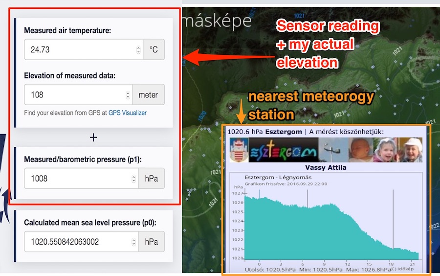

Back to my question for pressure conversion:
Is there any formula to convert raw pressure reading to the more used mean sea level?
(there was an answer for hPa to inHg conversion -> I am not looking for this)
Here is what I mean:
Mean sea level pressure calculator (converter) – Simple formula
On the page is the formula too:
p0 = Calculated mean sea level pressure
p1 = Measured/barometric pressure
T = Measured air temperature:
?? = Elevation of measured data
p0 =p1 (1-0,0065h / (T + 0,0065h +273,15))^-5,257
Is there any way to implement this calculation to ESP Easy or use as a formula in the device settings? Or I don't need this formula at all just the offset between calculated mean sea level pressure and raw pressure?
As I understand it, the offset is based on the temperature so you would have to calculate it for different temperatures, but I don't think you can put that formula in as it is.
I think you would have to have the calculation hard coded in the plugin, or do it externally.
I generally am only looking at the absolute change in pressure locally, but I can see where this would be needed to be able to compare to other locations, which would make it more useful in my opinion.
On that basis they might be willing to update the plugin. Or they might suggest you try to update it in the playground.

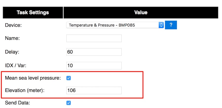

I successfully implemented the formula in the BMP085 plugin, but one thing is not working. How do I save custom variable in EspEasy?
I am now trying SaveTaskSettings(event->TaskIndex); but this function is undocumented and I don't know that this is the right way to save config or not.
There is also an another function: SaveCustomTaskSettings.
Edit: SaveTaskSettings(event->TaskIndex) - doesn't seem to work. It holds the value for a while, then lose it.

I just received today a BME280 sensor and guess or not it's showing weird values as well as my other sensors.
I am comparing values to my weather station.
Summary:
BMP280 -> +1C above actual temp
HTU21D/SI7021 -> -0.5C below actual temp
BMP180 -> pretty accurate
DHT22 -> -0.5C /humidity totally inaccurate %value%+20/
BME280 -> +1C
I know that this is more or less in the specified accuracy, but I am little bit disappointed. For the money a DS18B20 temperature sensor is a better choice - if you need measure only the temperature.
What do you think?
Summary:
BME280 -> +1C
What do you think?
From all BMP280s I have the positive temperature shift is consistently present and the pressure differs between individual BMP280 boards (+/- 1,5 hPa). Maybe they are calibrated during manufacture and some external factors (soldering, transportation from seller in China) make the calibration invalid? Luckily we have the formula field, so we may adjust the temperature if it is consistently shifted in Temperature formula field by say
On that note, can we make more complicated formulas than that, e.g. ax*x+bx+c? The code in Misc.ino seems to indicate this possibility, but I am not sure.
Concerning the DHT and humidity values:
%value% -1
- they may be influenced by soldering (significant decrease in reported humidity) or on the other hand some manufacturers expect soldering and if you use the sensor placed in connector/bredboard the reported value may be higher
- the weather station (esp. cheaper) may report inaccurate values as well - cheaper sensor, ageing
I know that this post is a year old, but if I may clarify (for novice users)...costo wrote: ↑16 Sep 2016, 22:10 It is very simple.
- Actually, if all of your boards have pull-ups, you may need to remove some of them! Since they will be in parallel the effective resistance will be reduced!
The actual resistance required for the buss to function is dependent upon buss speed and buss capacitance (however you may find any old value will work!).
If we take the above, and we have three devices with resistors built in, at say 2k4 ohms then the effective resistance will be only 800 ohms
since R= 1/(1/r1 + 1/r2 + 1/r3) or 1/(0.0004166667 * 3 ) = 1/0.00125) = 800 ohms
at four we have just 600 ohms
- Having several of the SAME sensor is not quite that simple of course! Many, but not all I2C devices will have (usually) 1, 2 or three additional connections, usually designated A0, A1, A2 (some may have more) Some are pulled up, some down to take effect (see manufacturers notes). These pins allow the I2C address to be changed.
This allows two similar devices having the same base address to co-exist.
Let's assume the device sits at the default address 0x80, if we tie A0 on one device to high, it's address will be 0x81. Thus if we have 3 Address bits A0, A1 & A2 we can have eight identical devices on the same buss (note that some devices of different types may share the same base address - don't assume, use a buss scanner. I use "i2c_scanner" which has been tweaked by several people and indeed I have my own mods that identify devices that I use, as well as their address)
If we want to control more devices than the manufacturer allows, by supplying a limited number of address pins, then we usually use a second I2C port as the simplest option.
