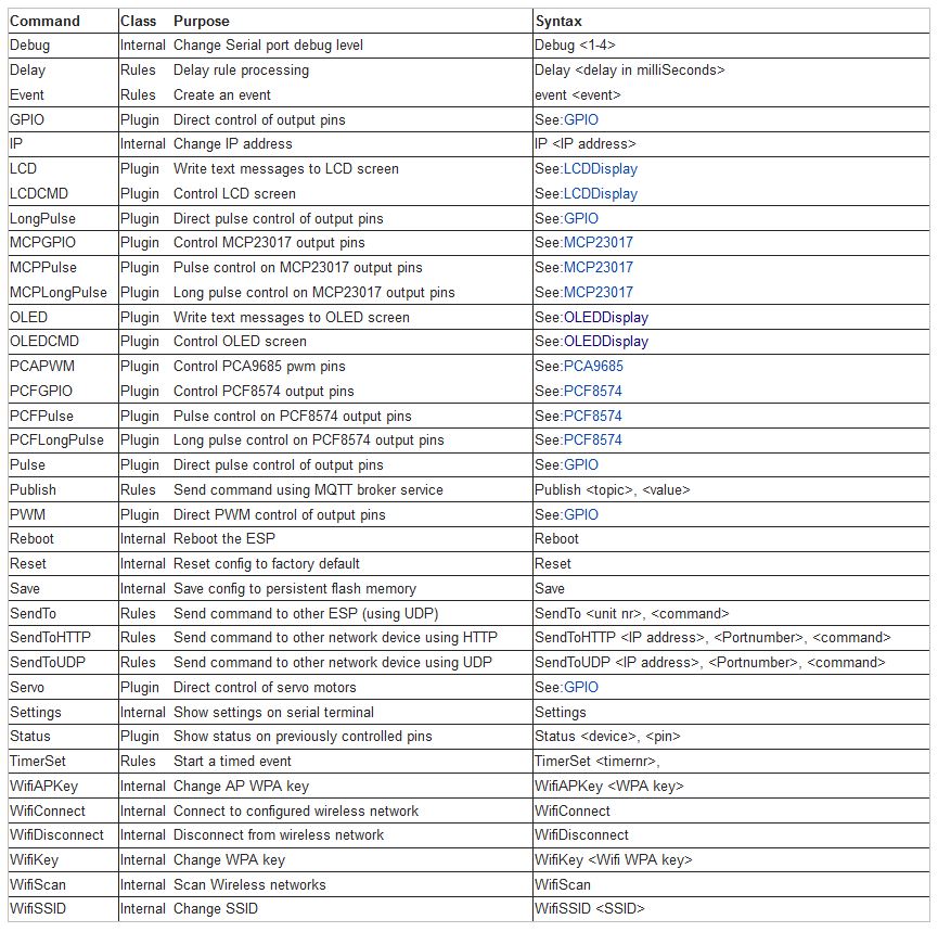

Use a terminal program like ESPlorer. You can view the settins with command: settings
With WifiSSID <SSID> and WifiKey <Wifi WPA key> you can change your settings.
Then Save and Reboot
Succes.
ESPEasy Commands.JPG (196.28 KiB) Viewed 3985 times

When I connect using 57600 or 115200 or 9600 I don't get any response from the board.
Are you sure this works with ESPEASY firmware? or do I need a different baud rate?

Did you cross TX and RX?
