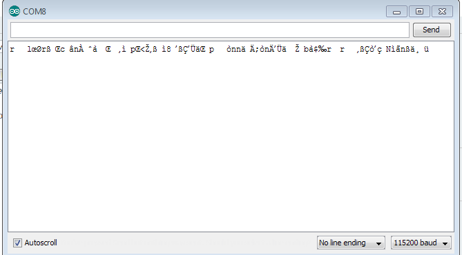

Could you start the serial monitor in Arduino and set the baud rate to 115200. Then power on the ESP and check the output on serial monitor.
Post the results here, so we can have a look at the boot process.

Martinus wrote:Could you start the serial monitor in Arduino and set the baud rate to 115200. Then power on the ESP and check the output on serial monitor.
RX -> TX
TX -> RX
CH_PD -> 3.3V
GPIO 0 -> floating (Didnt connect to anything)
VCC -> 3.3V
GND -> GND

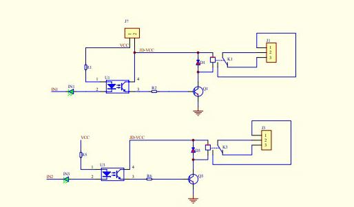

I ordered a board with 4 relays that uses opto couplers at the input.
http://www.ebay.nl/itm/270872712821?_tr ... EBIDX%3AIT
When I connected it to the 3.3 volt and put the ESP low (these boards have reverse logic) I saw the LED of that relay light up..........but the relay did not switch.
So I started to troubleshoot with the schemaics and measured around the board.
I found out the the 3.3 volt from the ESP is not sufficient to open the transistor at the other side of the opto coupler pin 3 and 4.
So the emitting diode of the opto does not open the transistor.
With 5 volt at the input it worked perfectly so I placed the wire coming from the ESP to the emmiter of the opto coupler transistor which is the base of the transistor that is switching the relay. Probem solved but a hack I do not like.
99% of the relay boards are 5 volt logic and it might work or might not depending on the tolerance of the three parts in the first line.
I have one that worked with an optocoupler with same specs.
The input line pin 1 and 2 of the optocoupler has a resistor that need to be lower in value to get this line working on 3.3 volt.
You can try to solder a 470 ohm resistor in paralel with the SMD resistor in the first line to see if that works.
So take care if you stumble on this.

OK step by step.
For all ESp module if you switch it on and there is no code chaching state of the output the pinoutput is LOW!!!!!! or not active or what you want to call it.
LEDS only.
You are switching VCC by the ESP pin!!!!! not GND so you use current sourcing.
ESP is swithed OFF.
You connect led with serial resistor between ESP pin and gnd.
LED is OFF as the pin is LOW.
ESP is switched ON.
LED is OFF as output is active LOW.
Now with OPEN HAB you can send HIGH signal to ligth up LED (active HIGH) and send LOW signal to dim LED (active LOW).
SO HIGH is LED ON and LOW is LED OFF.
Relay only.
You are switching GND by the ESP pin.
ESP is swithed OFF.
Your relay board first needs a VCC 3.3volt and a GND connection to work at all.
And you connect an input wire pin of relay board to an ESP pin.
Relay is OFF.
ESP is switched ON.
Relay is switched ON. Dang this is not what you want...... but the ESP pin is LOW at start up?!?!
Measure it with a simple DVM digital volt meter.
The pin of the ESP is LOW and if you look at the schematics this causes the LED of the opto couler to switch the transistor and so the relay ON.
The LED of the opto coupler is switch by ground not by VCC as is the regular LED in your other connection.
Now you toggle the state of the relay in OPENHAB and then an active HIGH from OPENHAB causes the optocoupler led to dim and switch OFF the relay. So reverse of what you want. And toggle will change state but in opposite way as with a cold start up.
An active LOW switch ON the relay. This is called reverse logic.
If you connect your regular LED to VCC and switch the GND you have the same reverse logic as with the relay board.
You are using current sinking.
All VCC points on the relay boards are connected so you cant reverse to positive switching as with the regular leds.
Let me know if this what you see happening and this answers the question.
Paco
Backbone
Posts: 106
Joined: 06 Oct 2015, 22:12
Re: ESP8266 01 uploading easy easy firmware
#20 Post by Backbone » 27 Nov 2015, 13:43
current sinking
Could not add this pic in previous respond.

Case 2:
On powering circuit:
gpio 00 -> Relay input
common gnd
Relay state-> ON . Input pin is HIGH unlike in the case of LED.By default it is in the ON state.
Using openHAB I send OFF command ->Relay OFF
ON command -> Relay ON
step 2:
openHAB ON -> Relay ON
openHAB OFF -> Relay OFF
Facing problem with relay & attiny85. Initial reading is ON unlike in case 1.
I think, I am facing this issue with the devices that do not have pull-up/pull-down resistors. I am not using any transistors etc., for switching.
Should I make changes in the circuit. ??
