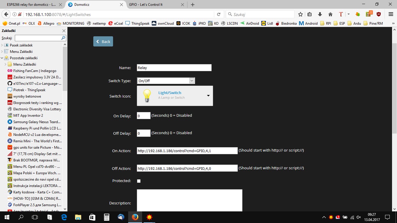

I check but without results. This is possible with R120 or R147 ? I want only connect relay on and off. Time for switch on i want to set in Domoticz.

Basic on/off
We can control a pin with simple http url commands. To change the pin to high or low steady output:
http://<ESP IP address>/control?cmd=GPIO,<pin>,0
http://<ESP IP address>/control?cmd=GPIO,<pin>,1
https://www.letscontrolit.com/wiki/index.php/GPIO

This is easy. Thank you. What pins connect relays to esp-07 ?

#5 Post by insippo » 14 Apr 2017, 15:13
Thank you. I try.
