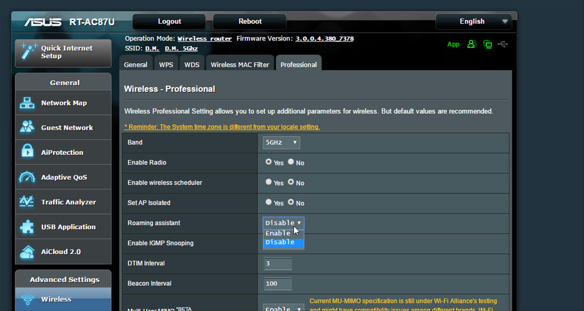

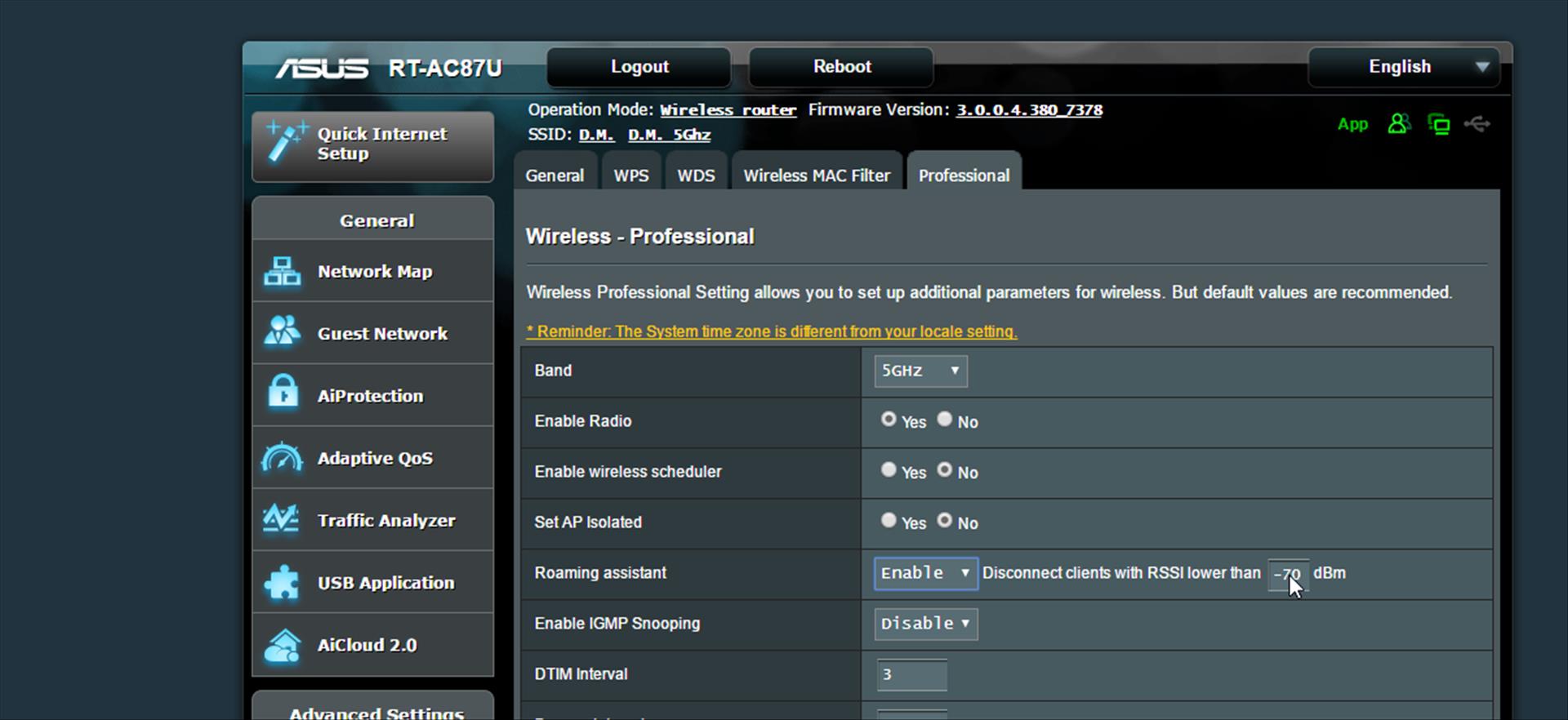

Re: ESP lost Wifi connection
mm
Think i found the bad guy... This was enabled and i think this disconect on servel times.... grrrr
I run now for a few days on disabled and there are no problem [ yet ]
