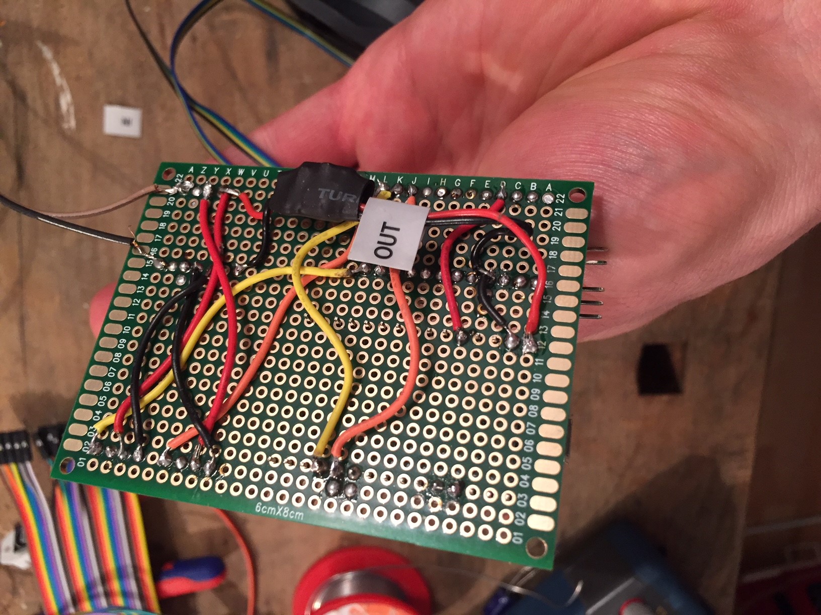

Re: Change PWM Frequency ?
Meine Lösung
- 3.jpg (551.95 KiB) Viewed 64881 times
- 2.jpg (510.71 KiB) Viewed 64881 times
- 1.jpg (599.96 KiB) Viewed 64881 times

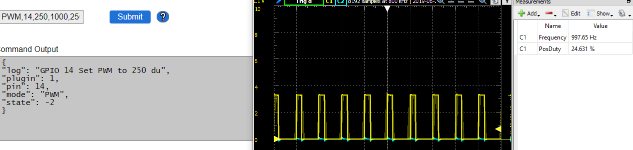

Hey guys,
i am desperatrly looking for a release which includes working PWM-Frequency settings.
I read that the moving from the GPIO functionality out of the Swith-Module caused some problems, and that this might caused the functionality was removed accidently.
I am happy for any hints in this direction =)
The lastest release:
-duty-cycle is set correctly, but the frequency remains at 1kHz instead the 2.5kHz as in the command
wanted.
The command leads me to this outcome.
I am using to PWM-Power some Fans with that, sadly we can hear the 1kHz, so 20kHz would be nice
PWM,14,250,1000,2500
INIT : Booting version: mega-20190607 (ESP82xx Core 2_4_1, NONOS SDK 2.2.1(cfd48f3), LWIP: 2.0.3 PUYA support)
59 : INIT : Free RAM:24960
60 : INIT : Warm boot #6 - Restart Reason: External System
62 : FS : Mounting...
87 : FS : Mount successful, used 75802 bytes of 957314
438 : CRC : program checksum ...OK
475 : CRC : SecuritySettings CRC ...OK
583 : INIT : Free RAM:22160
585 : INIT : I2C
585 : INIT : SPI not enabled
599 : INFO : Plugins: 47 [Normal] (ESP82xx Core 2_4_1, NONOS SDK 2.2.1(cfd48f3), LWIP: 2.0.3 PUYA support)

I found a spec describing PWM.
PWM Control Input Signal
he following requirements are measured at the PWM (control) pin of the fan cable conne
WM Frequency: Target frequency 25 kHz, acceptable operational range 21 kHz to 28 kH
Maximum voltage for logic low: VIL = 0.8 V
absolute maximum current sourced: Imax = 5 mA (short circuit current)
absolute maximum voltage level: VMax = 5.25 V (open circuit voltage)
I was thinking i could stop the fan with pwm 0, but this seems not to be the case.
Is it a characteristic of the fan how fast or slow it can go at certain pwm levels?
How could i control the fan to also stop? Any idea?
Thanks and best regards,
Stefan
Oh ok, i think i see our misunderstanding.
I have a pwm controlled 12 V Fan for PC CPU.
It has a 4 Pin terminal.
Ground
12 V
Tach
PWM
I connect Ground and 12V to the Fan.
Also i connect my ESP to the same Ground.
I connect PWM to my ESP.
Now i can control the fan with the ESP by driving the PWM input of the Fan.
If i understood it correct the fan has its own regulation steered by the PWM input of the fan.
But i think the FAN has its own logic which says for PC that it runs always at 500 RPM and you can control it up to 1200 RPM with the PWM signal.
I think this is a build in logic so that the CPU Fan in the PC never do not turn.
I ordered now a PC Case Fan and hope that i can switch it off, but even with a PC Case fan i am not sure if a stop is implemented in the pwm logic of the Fan.
Do you think i understood this correct?
Stefan
Ground
12 V
Tach
PWM
Stefan
