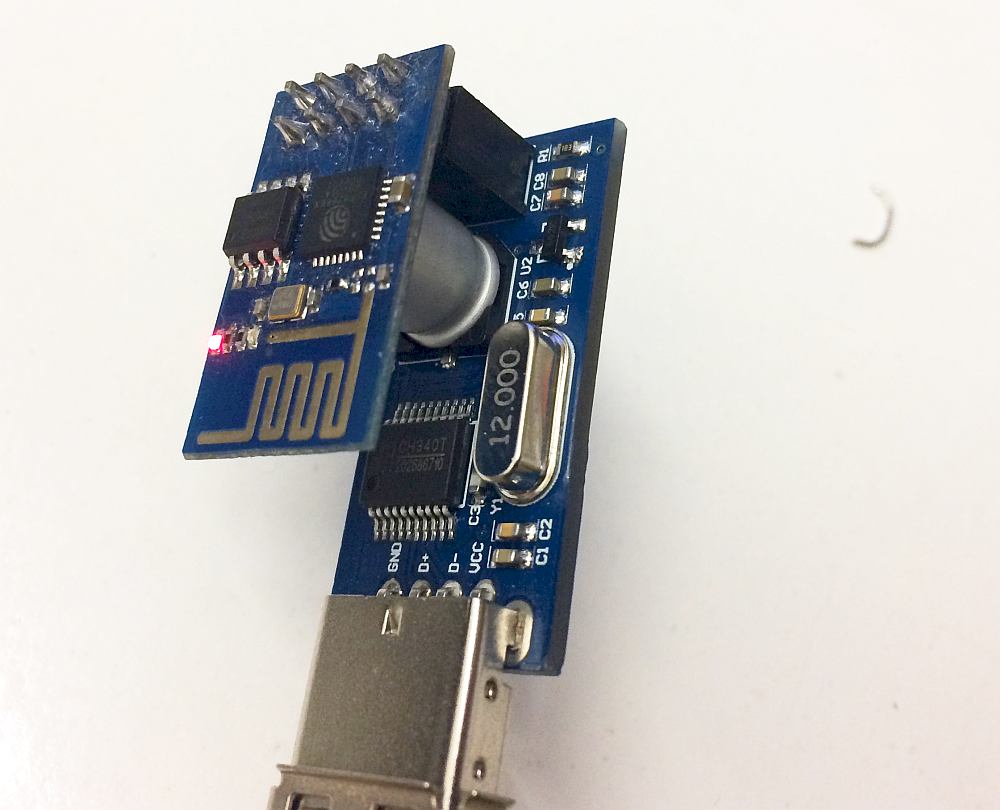

On the ESP-01 I just made a bridge on the back side, between GND and IO0 to be able to flash it. It starts flashing, I get the message Success flashing and then, remove the bridge on the back and reboot. But I don't see any wifi to start configure it.
I also tryed nodeMCU flasher, but ith this it takes much longer to flash, and in the end it hangs up and in the LOG tab I see the error you see in the pic bellow.

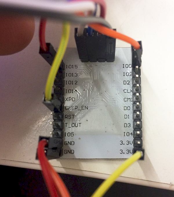

On the other board, the ESP-12, I connected some female jumper wires from GND to IO0, from GND to IO15, from 3.3v to CHIP_EN as you can see in the bellow photo, and while flashing with ESPEasy Flasher I get the same success message at the end of the process, but after rebooting , I don't see any new wifi to set it up.
On this board I tried to upload a test program from the arduino IDE and it was successfull, it also connected to my network, and my Dashboard has notified me that new device connected to my home network. The device is working, but I don't know what's wrong when trying to flash using ESPEasy.
Do I need to have any pin HIGH or LOW to power on the ESP after flashing ?

at first the white board is not an ESP-12, it is an ESP-201.
Anyways.....
If i remember right the "blue" ESP-01 has 512KB memory, only the ones with black PCB have 1 MB.
The ESP-201 definitely has 512KB flash.
512 KB is no longer supportet - the smallest ESP-2.0.0 version is bigger then 512KB.....
