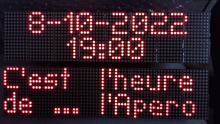

My wife said that when inside the swimming pool we cannot see what time it is.
With a lot of trials I succeded to use 2 Dot matrix with each 2 x 8 modules to display date, time and air and water temperature with following release
Build :ESP_Easy_mega_20220809_display_ESP8266_4M1M Aug 9 2022
All is done by mean of rules and at some times i use to give to ESPeasy a kind of french artificial intelligence see picture (french language)!!!!!
I would like now to play sounds at these particular times, but rtttl command is not valid and fails as the tone command is OK.
I think I will have to do my own build with also other plugins that I need.
Is somebody aware to explain what to do when building with PlatformIO to be sure that the rtttl command will be OK and not desabled as I read in some messages.
Many thanks for help

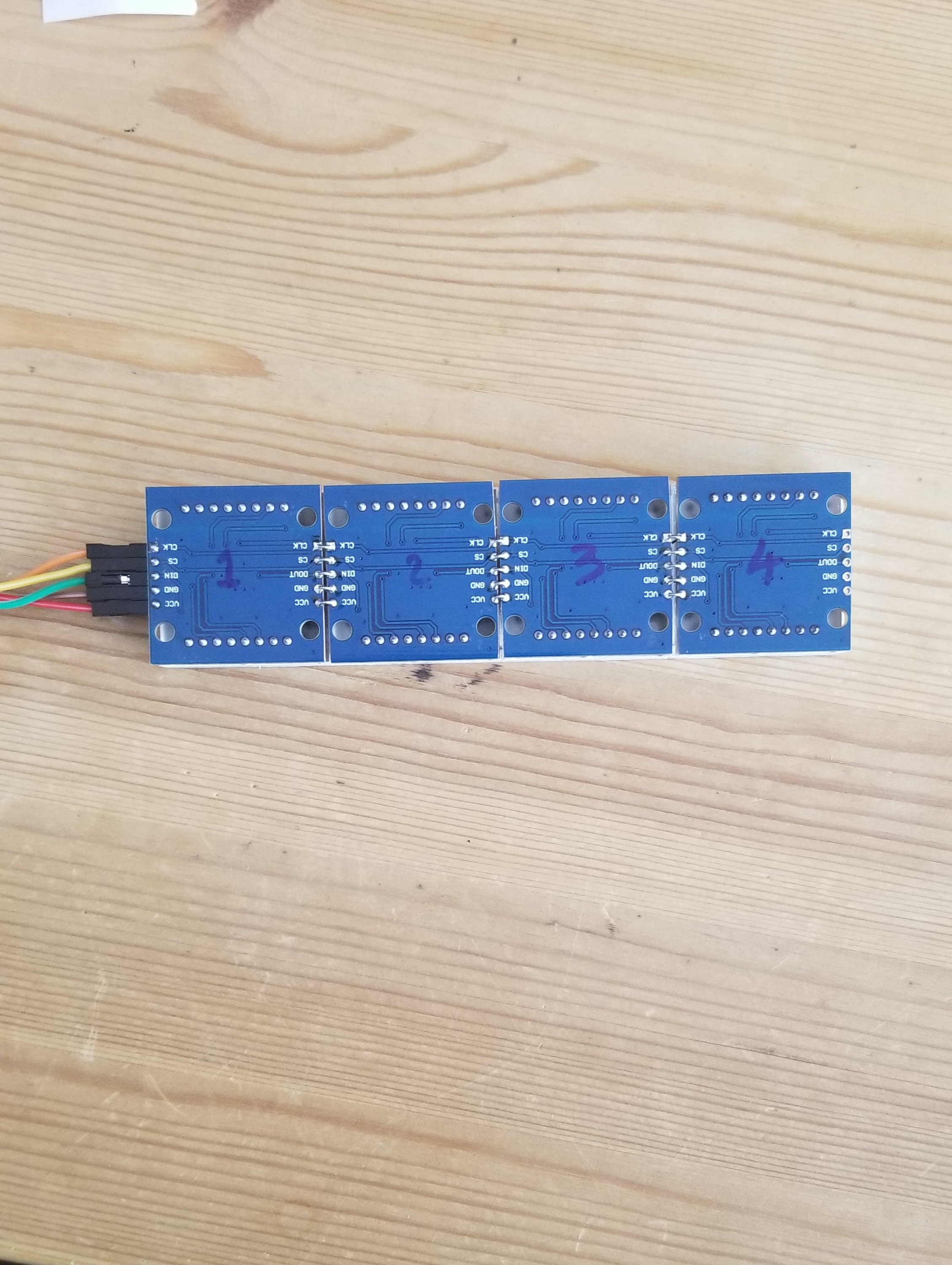

#20 Post by lesovoz85 » 03 Nov 2022, 11:31
I have
Wemos D1 Mini and dot matrix display Max7219. When connected, it shows garbage. firmware mega-20211105

#22 Post by Ath » 03 Nov 2022, 13:08
It looks like you are using the 7-segment display plugin using the display type MAX7219 (P073) instead of the required MAX7219 dot matrix plugin (P104) for this type of display. That last plugin (P104) is only available in the Display builds.
This has confused other users before (and was the original reason that P104 was created ;)).

That's the 7-segment display plugin (P073), not the MAX7219 dot matrix plugin (P104), as I suggested could be the cause...

Does SPI need to be enabled for this plugin to work?
Re: Esp Easy max7219 Dot Matrix
#34 Post by Ath » 05 Nov 2022, 12:27
Yes, SPI has to be enabled for this device to work.
