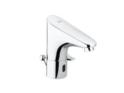

A well known manufacturer is "Grohe" in Germany.
The infrared light barrier (Sender & receiver) resides inside the tap's socket behind the dark oval.
Should be possible to make something similiar.
