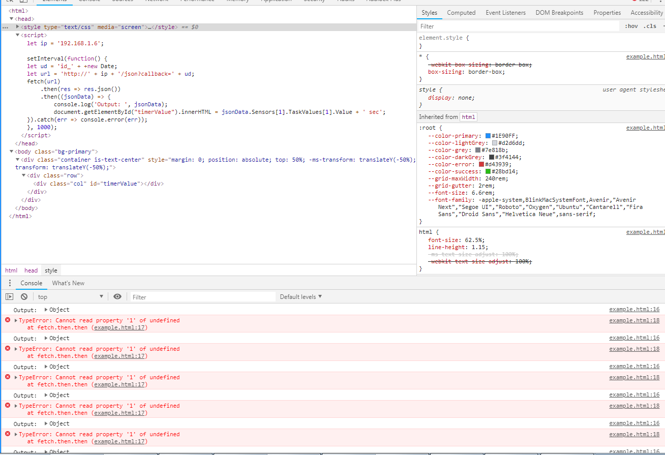

You could simply create a html file with this code inside. Change ip number and change the sensor + task number to match your setup, and it'll fetch the values for you.
The "magic" happens here...
<script>
let ip = 'XX.XX.XX.XX';
setInterval(function() {
let ud = 'id_' + +new Date;
let url = 'http://' + ip + '/json?callback=' + ud;
fetch(url)
    .then(res => res.json())
    .then((jsonData) => {
        console.log('Output: ', jsonData);
		document.getElementById("timerValue").innerHTML = jsonData.Sensors[0].TaskValues[0].Value + ' sec';
}).catch(err => console.error(err));
}, 1000);
</script>

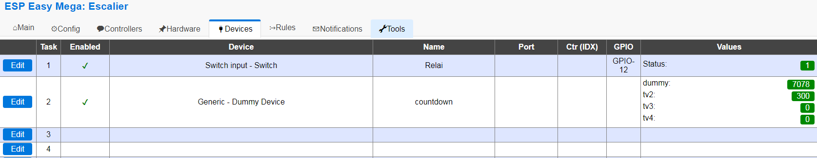

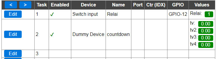

Here is the device section:

Study your names and you'll see what's going on. (That's why I never use same names for tasks and their values).

got it : relai(french) and relay(English)
The eye of the tiger :)

Sorry but It doesn't work yet. the dummy device value remains 0.The four value names are : dummy, tv2, tv3, tv4)
Any idea ?

Here is the log: I am wondering if there is an issue with [VAR#1].
60180103 : EVENT: countdown#dummy=0.00
60181005 : EVENT: countdown#tv2=0.00
60181907 : EVENT: countdown#tv3=0.00
60182819 : EVENT: countdown#tv4=0.00
60183727 : EVENT: Clock#Time=Fri,10:16
60184632 : EVENT: Rules#Timer=8
60185330 : ACT : Let,1,-1
60185536 : ACT : TaskValueSet,2,1,
60185542 : ACT : TimerSet,8,1

The device section shows:
When i trigger the rule, then Relay device value becomes = 1 , the light is switched on.
There should be something wrong, that I don't see...
What do you think about the value of [VAR#1] not shown in the log. Is it normal?

I have just added a line in the rule to assign the value 300 to the variable number 2 (tv2) and I can see it in the device section.

#23 Post by Gilles » 08 Mar 2019, 15:22
I had tested it , but i only get a blue background.
I have edited the example.html file changed the blue lines.
<script>
let ip = '192.168.1.6';
fetch(url)
document.getElementById("timerValue").innerHTML = jsonData.Sensors[2].TaskValues[2].Value + ' sec';
Re: Get the timer value
#24 Post by grovkillen » 08 Mar 2019, 15:35
Change those 2 to 1... In programming we start counting at zero.
#25 Post by Gilles » 08 Mar 2019, 15:43
It doesn't work for me with Chrome.
The inspect console shows some errors
Really sorry,
Gilles
#26 Post by grovkillen » 08 Mar 2019, 16:18
If the task is on the first value then it should be:
jsonData.Sensors[1].TaskValues[0].Value + ' sec';
And people, please experiment...

#27 Post by Gilles » 08 Mar 2019, 16:36
you are right, In my case, it is the second sensor and the second value so it should be jsonData.Sensors[1].TaskValues[1].Value + ' sec'; I have even tried several combinations.
Maybe there is something wrong with the espeay version that I run.
Don't worry, I will write a python script to get the json and extract the value of the sensor.
Gilles

#28 Post by Gilles » 09 Mar 2019, 08:44
I have upgraded the sonoff esp to: ESPEasy_mega-20190225
Everything works as it has to.
I can get the dummy variable
and your java script is fantastic:)
