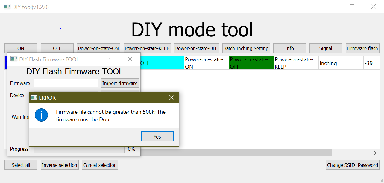

kimot wrote: 04 Jan 2020, 00:09 Instead of Tasmota bin file use appropriate ESPeasy bin file.
ok, but which one?
ESP_Easy_mega-20191208_minimal_core_242_ESP8285_1M_OTA.bin is too big:

#23 Post by Grumpf » 24 Jan 2020, 15:31
Same problem I managed to install Tasmota but then no firmware from espeasy works. Even if it's actually smaller than 508 like ESPEasy_2step_UploaderMega_1024. :(

#24 Post by amiable » 25 Jan 2020, 21:52
I finally gave up with the OTA update. I soldered the cables and uploaded the firmware using an external programmer (ESP_Easy_mega-20191208_normal_ESP8285_1M).

I've backed up the original firmware and flashed a custom firmware on a sonoff mini with my FTDI adapter without soldering, it was a little but tricky but I've used a clip to clamp a jumper wire on the 3,3 v pin and used the ground pin on top of the board, I then pressed the button that's connected to GPIO 0 and connected my FTDI adapter. I then used my hands to hold down the RX and TX pins in the flashing process. It's a bit tricky, but it works. I'm using esphome for a my sonoff device's because it gives me more freedom in how I use them. Here's a picture with my esp home configuration for the mini.

amiable wrote: 25 Jan 2020, 21:52 I finally gave up with the OTA update. I soldered the cables and uploaded the firmware using an external programmer (ESP_Easy_mega-20191208_normal_ESP8285_1M).
now I have used the ESP Easy Flasher with the ESP_Easy_mega-20191208_normal_ESP8285_1M file in combination with the module seen here (https://www.thingiverse.com/thing:3767667) mini is now listening to my commands from Domoticz
For people who will have some Pogo pins, I have some here for postage in the Netherlands.

I just flashed a Mini with Tasmota-lite as a test, following this guide:
https://sigmdel.ca/michel/ha/sonoff/sonoff_mini_en.html
I used the curl method on my rpi4 running Apache as the fileserver. Some fiddling with the strings did the trick because the strings in de guide use line breaks /, that didn't work for me, putting the complete string in one go worked. Next job is to get espeasy on the minis.
