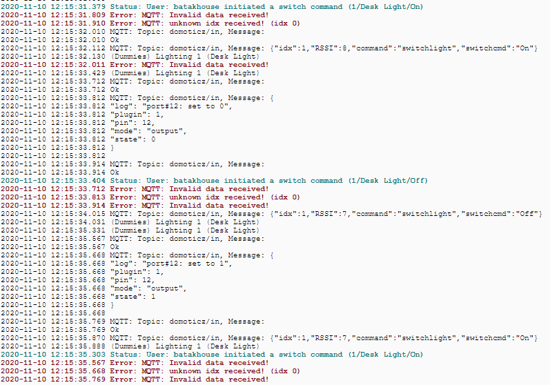

All works now but i get error messages in Domoticz when i trigger the switch from Domoticz. Not critical but maybe worth to mention. Haven't really investigated it yet though.
