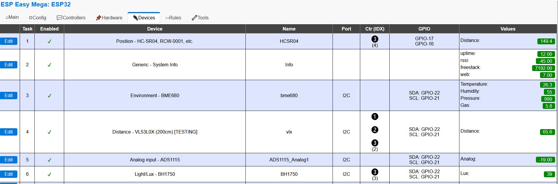

I have problems with Thinkspeak, the data is only partially arriving
Just updated to mega 20210802
ESP_Easy_mega_20210802_test_B_ESP32_4M316k.bin
I configured the Thinkspeak Controller as follows:
Task 1, 4, 60 controller no.3 should be transferred
However, only data from controller no. 1 and 4 are displayed.

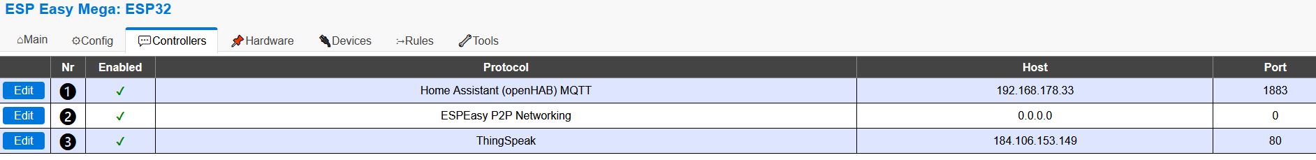

What Controllers are configured at slots 1 and 2?
I'm not quite sure is that what you mean?

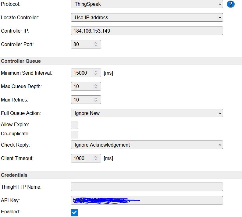

#9 Post by TD-er » 08 Aug 2021, 00:17
What interval is used to send data to the controller?
So the interval of the tasks.
You have the controller set to only send a message every 15 sec and the queue full action is set to "ignore new".
I think with the large interval needed by Thinkspeak, you may want to set it to "delete oldest".
Also try to make a list of values you try to send and at what interval.
It could be you're filling up the queue with messages from only 1 or 2 tasks and ignoring the rest because the queue is full.
