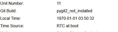

I had to change the battery in the DS3231 chip and the following time is displayed when booting.
How can I tell the DS3231 chip the new/correct time?

Re: External Time Source -DS3231 need help
#5 Post by TD-er » 18 Dec 2021, 11:14
Just power cycle the board and if it does show a time which should match with the last seen time, then it is reading from the RTC chip and the chip is counting, powered from the coin cell.
Just set the time using NTP once, or use the datetime command

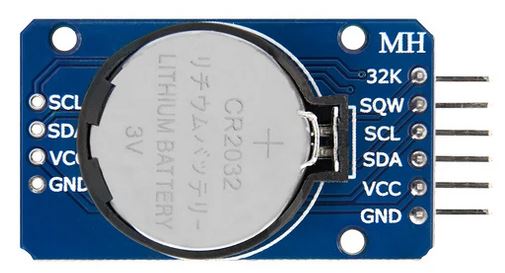

I connected the chip to IC2 (D1 / D2),3V,GND. The chip has an additional pin header with SDA, SCl, 32K, SQW.

everything back it works, I idiot inserted the battery incorrectly; - ((sorry

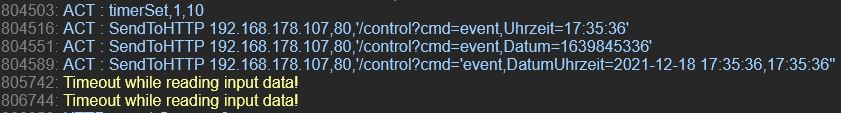

ESP that sends
SendToHTTP 192.xxx,80,"/control?cmd=event,Uhrzeit=%systime%"
SendToHTTP 192.xxx,80,"/control?cmd=event,Datum=%unixtime%"
SendToHTTP 192.xxx,80,"/control?cmd='event,DatumUhrzeit=%lcltime%,%systime%'"
ESp who receives
Is it possible to use the Unix time? The only thing I don't know is the conversion.

Hmm, looks like the SendToHTTP command does mess up the quotes in some way.
Dondolo wrote: 18 Dec 2021, 17:42 ESP that sends
You might want to use the date and time separate:
SendToHTTP 192.xxx,80,"/control?cmd=event,DatumUhrzeit=%sysyear_0%-%sysmonth_0%-%sysday_0%,%systime%"

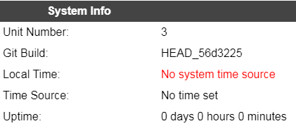

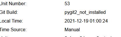

So everything is transmitted correctly and the receiver ESP can process it. Only the time is still an hour higher, maybe winter time or summer time?
SendToHTTP 192.168.178.107,80,"/control?cmd=event,ClockDate=%sysyear_0%-%sysmonth_0%-%sysday_0%,%syshour_0%:%sysmin_0%:%syssec_0%"

#16 Post by Ath » 19 Dec 2021, 09:58
The sending command includes 2 arguments, one for the date and the second for the time.
As the datetime command expects 2 arguments, you will have to pass these separately:
on DatumUhrzeit do
  if %sysyear_0% <= 1970
    Datetime,%eventvalue1%,%eventvalue2%
NB: %eventvalue% is equivalent to %eventvalue1%.
The 1 hour diff is probably caused by the time-zone you're in, CET? Or DST setting (though we're not in DST, currently).

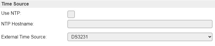

I ran into a problem, I can't configure the ESP to work with DS3231.
ESP-01S module (ESP_Easy_mega_20220616_normal_ESP8266_1M), RTC (HW-84) on a DS3231 chip.

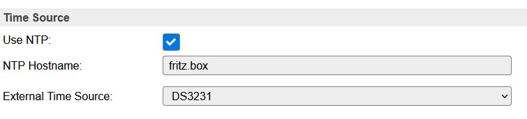

In Tools/Time Source/External Time Source, I select DS3231.

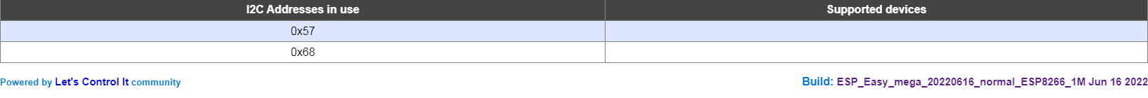

I go to the Scan for I2C devices tab, there are, as it should be, two addresses on the I2C line. AT24C32 - 0x057 and DS3231 - 0x68.
But the Supported devices column is empty!?
In the Special and Experimental Settings/WD I2C Address, I set the address "104" (0x68).
Is it something I'm doing wrong, or do controllers with a small amount of memory (1M) not support this function?

The Time Source and Watch Dog setting are in no way related, so please leave the WD setting at 0. It might unexpectedly reboot the unit.
Getting the Time Source to 'stick' (as in: actually use that Time Source) it expects the NTP setting to be off, and probably a few reboots.

Ath wrote: 26 Oct 2022, 10:03 The Time Source and Watch Dog setting are in no way related, so please leave the WD setting at 0. It might unexpectedly reboot the unit.
Initially, I did not touch these settings, there was no difference. There is no DS3231 in Supported devices!
#21 Post by Ath » 26 Oct 2022, 10:34
The device names are removed in some builds (only available in Normal, Custom and Max, AFAIR) to save some .bin space. If the address is shown, a device is recognized, but unfortunately you can't see what (supported) device it is.
We have some plans to make that list external, but that's on low priority for now.

#22 Post by igorka » 26 Oct 2022, 10:44

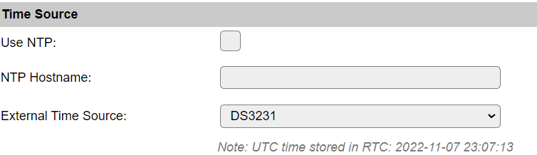

Then the time synchronization from DS3231 should work correctly?Why doesn't it work for me?I ask for help, what settings do I need to make?Maybe I'm doing something wrong?
#23 Post by Ath » 26 Oct 2022, 10:52
You will need to set the date/time of the device correctly once it's configured, to have it stored: https://espeasy.readthedocs.io/en/lates ... l-commands

Ath wrote: 26 Oct 2022, 10:52 You will need to set the date/time
Tools/Command Datetime,2022-10-26,12:03:00, Command Output OK.
System Info
System Info
After restarting the ESP, the time is lost:
System Info
System Info
Time Source
Time Source
The battery in the module is new, the voltage is 3V33, the voltage on the legs DS3231 is also normal, external power is also ok...
I conclude that my DS3231 module is faulty or defective.Unfortunately, I don't have an oscilloscope right now and I can't see if there is a signal on the 32 kHz pin.

I tried all pin combinations to connect i2c.When scanning the bus, it sees addresses, but it does not work to connect for time synchronization.Writes an error in the log as in the photo above.Maybe I should fill in another firmware for testing, and which one?

#49 Post by TD-er » 08 Nov 2022, 00:08
Finally came to testing the board and it does work just fine on my test setup.
2022-11-08 00_07_15-MAX ESP32.png (9.08 KiB) Viewed 14160 times
Also tested with power cycle to be sure it wasn't set, tested to reboot and see what time source was reported.
And as can be seen on the screenshot, the tools->Advanced page does show what is stored inside the RTC module.
