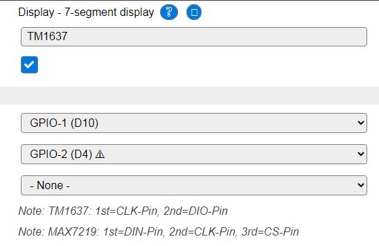

How to use the 7dt command. At the same time, my display just flashes. At the same time, 7dtext displays the temperature normally. На шине DIO-Pin у меня подключен LED. В автоматическом режиме часы он моргает только при изменении состояния, в ручном режиме моргает постоянно даже если информация не меняется.

What pins did you use to connect the display to?

ESP-01S

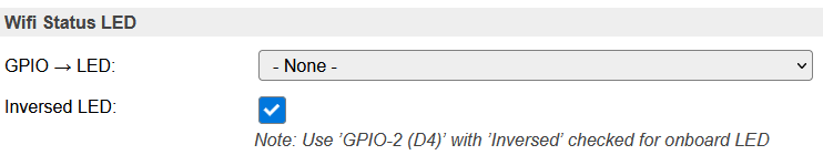

And you have not enabled the WiFi led feature? :
Screenshot - 20-04-2022 , 08_37_34.png (6.39 KiB) Viewed 6208 times
Because that will interfere with the display, as you would expect.

WiFi led feature is disabled, it does not prevent the display from displaying information. Only the 7dt function does not work.
