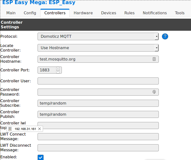

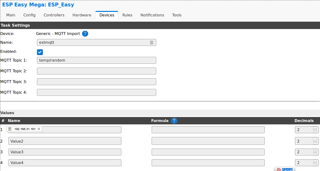

hello,
I need to take a temperature value from a mqtt broker
I used to test test.mosquitto.org.
With mqtt import I managed to import the value.
How can I now send the value to the display connected to espeasy?
thanks

On extmqtt#Value1 do
LCD,1,1,[extmqtt#Value1] //LCD,<row>,<col>,<text>
EndOn
