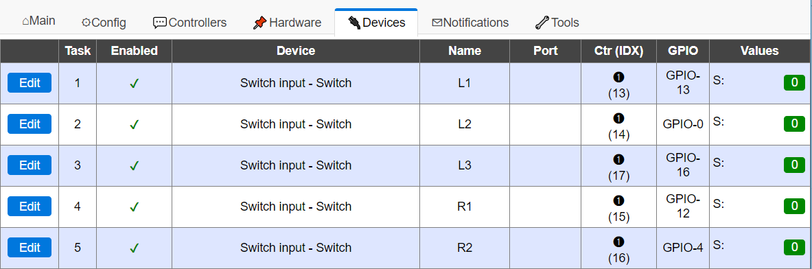

Here is my devicelist

I use <<ESP IP>>/control?cmd=event,L2on
My ruleset 1:
 On L2on do
 gpio,0,1 //Set input 0 High
  timerSet,1,1 //timer 1 set for 1 sec
On L2off do
  timerSet,1,0 //timer 1 set to halt,
  gpio,0,0 //Set input 0 low (normal state)
On Rules#Timer=1 do
endOn
The log output looks like this:
481240: EVENT: L2on
481250: ACT : gpio,0,1
481253: SW : GPIO 0 Set to 1
481257: ACT : timerSet,1,1
481284: Command: timerset
481337: SW : Switch state 1 Output value 1
481339: EVENT: L2#S=1.00
482048: WD : Uptime 8 ConnectFailures 0 FreeMem 14592
482736: EVENT: Rules#Timer=1
482752: ACT : gpio,0,0
482754: SW : GPIO 0 Set to 0
So the input gets HIGH and with help from the controller my homeseer device is set!
THANKS!!!!!!!! :D :D :D
