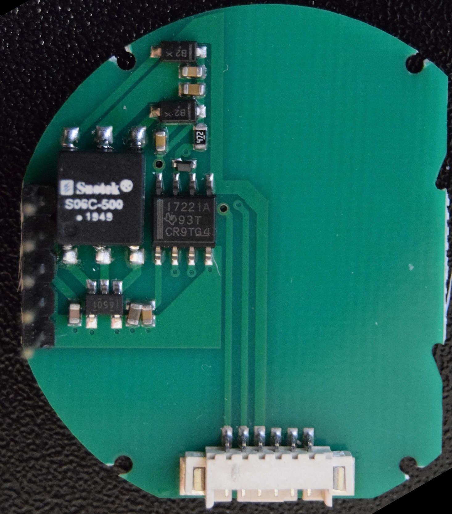

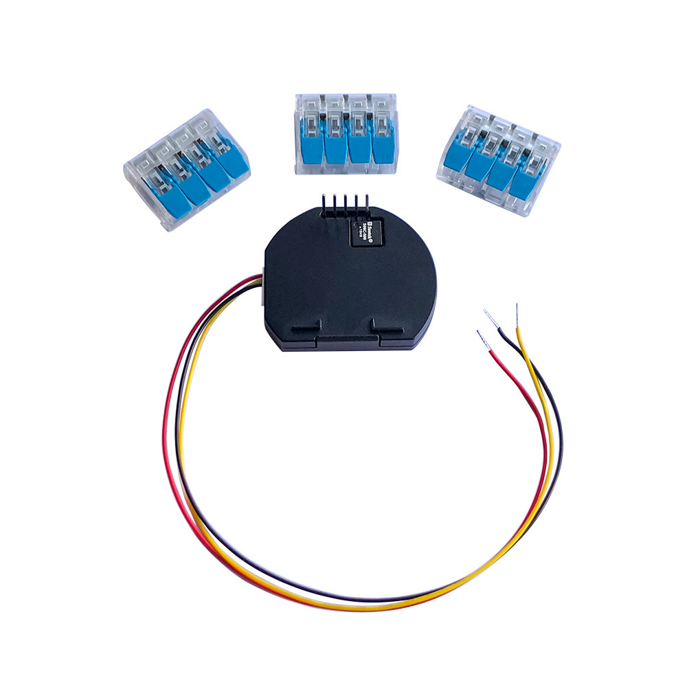

I added the picture of the official shield.
Thanks in advance!!!

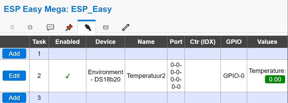

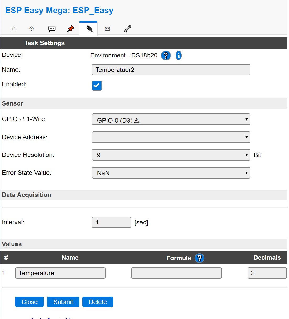

I've included all the printscreens and photo's of my setup.
I Used GPIO-0 but no reading.

The setup seen in the screenshot looks reasonable. Are you sure the shield and DS18B20 sensor are still good? I suggest re-testing them on the original Shelly firmware to confirm operation.

Unfortunately it shows that the DS18B20 temperature sensor will require two I/O pins: Output=GPIO-0, Input=GPIO-3. This isn't supported by ESPEasy's DS18B20 plugin.
It seems that the two GPIO pins are due to the isolation circuitry in the Shelly Shield. The shield uses a ISO7221A Dual Digital Isolator IC that supports two unidirectional signals. So the expected bi-directional access to the "One-Wire" DS18B20 has been split into separate input and output paths.
Long story short, ESPEasy currently will not support this particular Shelly application.
