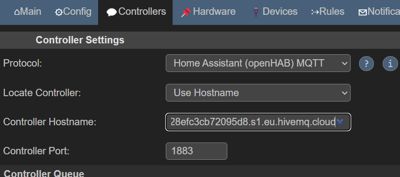

I just tried it here on a node and I can store the hostname just fine.
Apparently there is enough space (have not looked at the source code yet)
Screenshot 2024-08-28 110258.png (33.88 KiB) Viewed 4227 times
Screenshot 2024-08-28 110238.png (46.41 KiB) Viewed 4227 times
