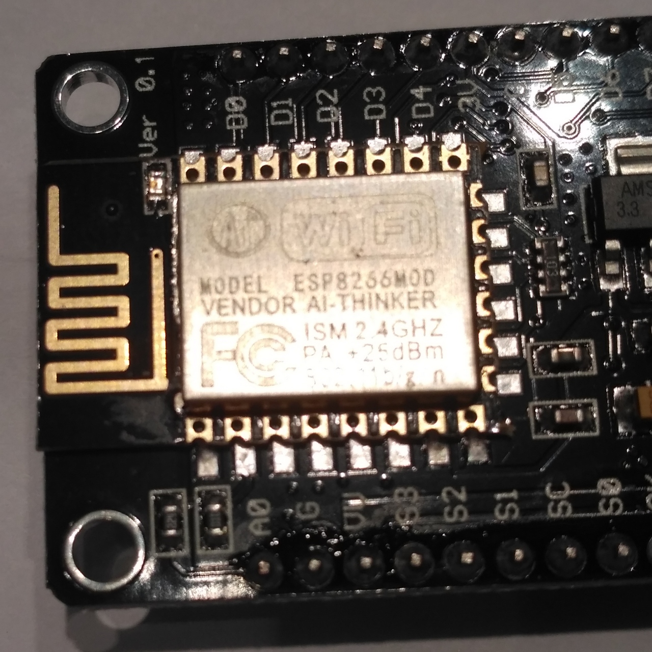

I have problem with NodeMCU V3 with AI-Thinker 8266 module. I flashed it with different versions (with different loading speed 9600, 115200) of ESP Easy firmware but the device does not show up as an access point ESP_EASY_0 or ESP_0. After boot only blue led blinks one time ant that’s all. When I connect to module with COM connection via Putty I see only randomly generated characters. During loading firmware there is no problem – it looks like everything goes OK, blue led flash during programming etc. It’s not my first NodeMCU board and previously I had no problems with flashing it. Photos of my board in attachments. Any suggestions how to load firmware into this module?

Hope there isn't a PUYA chip under that metal cover..... :shock:

@budman1758 not sure about what chip is under the shield but my NodeMCU and Wemos boards were obtained over the past 3 to 4 months and when I try other WiFi-enabled programs they work okay.
