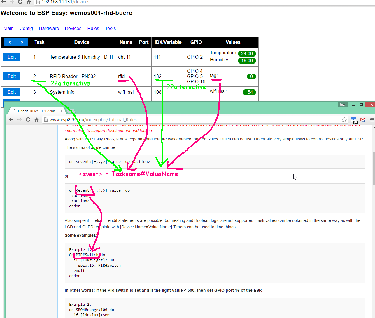

1) ----------------------------------------
would be helpful to have clearer explanation in wiki for the syntax of <event> creation.
i attach an image, if i got this right.
also a list of possible actions could help to prevent searching the source..

by inccident if found out, that one can check the right syntax in the log,
where EVENTS are logged like:
EVENT: wifi-rssi#wifi-rssi=-46.00
EVENT: dht-11#Humidity=19.00
maybe worth to mention in the wiki?
